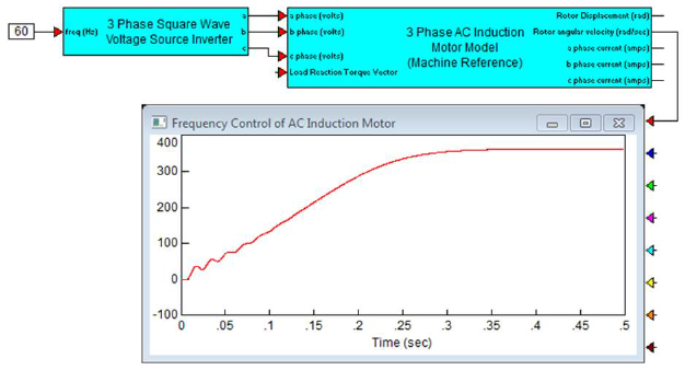

Description: The Three Phase Square Wave Inverter block provides bipolar three-phase square wave output from an input frequency.

The following illustrates a simple example of frequency control of a three-phase AC induction motor. Typically, the stator voltage is adjusted in proportion to frequency to maintain a constant flux. This provides easier adjustment of speed.
