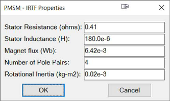

Magnet Flux (Wb): Indicates the estimated permanent magnet flux.
Number of Pole Pairs: Indicates the number of motor pole pairs.
Rotational Inertia: Indicates the inertia of the rotor (plus mechanical load if attached).
Stator Inductance (H): Indicates the measured phase stator inductance %FontSize=10
%TeXFontSize=10
\documentclass{article}
\usepackage{amsmath}
\pagestyle{empty}
\begin{document}
L
\end{document} of the motor.
Stator Resistance (ohms): Indicates the measured phase stator resistance %FontSize=10
%TeXFontSize=10
\pagestyle{empty}
\begin{document}
R_s
