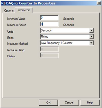

Creates a channel to measure the period of a digital signal.
Additional Information: Refer to the National Instruments NI-DAQmx C documentation.
Divisor: Indicates the value by which to divide the input signal.
Edge: Specifies between which edges to measure the frequency or period of the signal.
Maximum Value: Indicates the maximum value you expect to measure.
Minimum Value: Indicates the minimum value you expect to measure.
Measure Method: Indicates the method used to calculate the period or frequency of the signal.
Measure Time: Indicates the length of time to measure the frequency or period of a digital signal.
Units: Indicates units to use to return the measurement.
