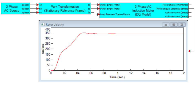

Diagram name: Park Transform Stationary Frame
Location: Examples > eMotors (Legacy) > Transforms
Park’s transformation is used in this example to transform a three-phase voltage source to DQ frame voltages for use on the DQ frame model.
