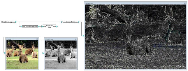

Example
In this example, the kernel size is 3 and the scale is 2.
LaplaceFilterExample
