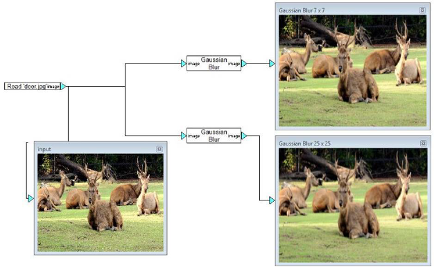

In this example, changes in the Gaussian settings show different blurring effects.
