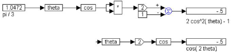

1. Computation of cos(2θ) = 2cos2(θ) - 1
With θ chosen to be π/3, the above trigonometric identity is realized as:
