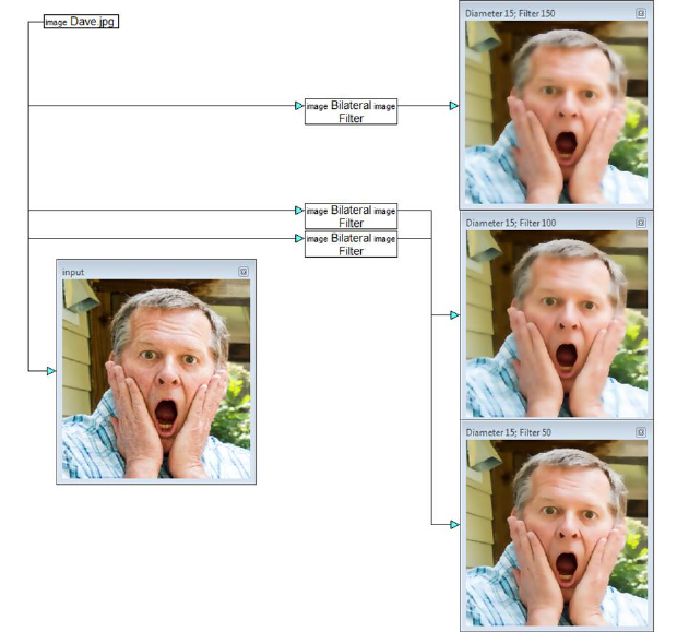

Example
In this example, three bilateral filters are applied (15;50, 15;100, and 15;150) to the image. As the filter value increases, the fine textures are filtered away while the contours and shading are preserved.
