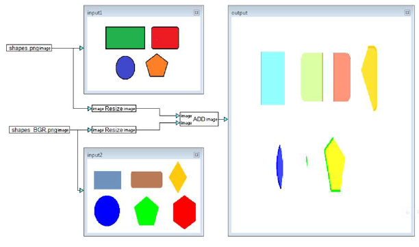

Example
In this example, the results of an Add operation is displayed.
