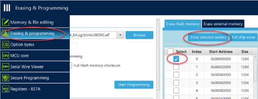

5. In stm32cubeprogrammer, click Erasing and Programming, then select index 0 of flash and click Erase selected sectors.
