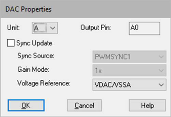

Description: The DAC block performs digital to analog conversions.
Gain Mode: Selects the output gain with respect to the reference voltage. This parameter is available only for devices that support it.
Output Pin: Specifies the output pin.
Sync Source: Determines which PWM sync will cause the DAC block input to be presented on the hardware. This parameter is available only for devices that support it.
Sync Update: Specifies the sync. This parameter is available only for devices that support it.
Unit: Specifies the unit.
Voltage Reference: Chooses the reference, voltage, and ground. This parameter is available only for devices that support it.
