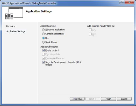

The Application Setting window appears.
BuildingCustomDLL3
6.    Do the following:
     Under Application Types, select DLL.
     Under Additional Options, select Empty Project.
     Click Finish.

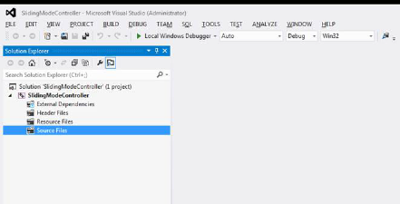

The Solution Explorer window appears.
BuildingCustomDLL4

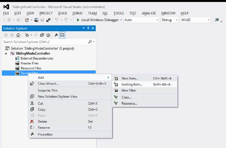

9.    Right-click Source Files; then click Add > Existing Item.
BuildingCustomDLL5

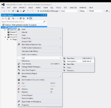

11.  Right-click the Project Name and select Add > Existing Item.
BuildingCustomDLL7
