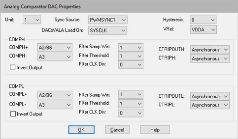

Description: The Analog Comparator DAC block lets you set up the on-chip comparator that compares an on-chip voltage reference to an external pin.
The Analog Comparator DAC block lets you set the value of the DAC on the comparator unit. It takes an input value between 0 and 1 in FX6.16 format. The voltage produced by the Analog Comparator DAC is the input value * VRefDac.
COMPH
COMPH+: See Texas Instruments documentation for detailed information on this parameter.
COMPPH-: See Texas Instruments documentation for detailed information on this parameter.
CTRIPH: See Texas Instruments documentation for detailed information on this parameter.
CTRIPOUTH: See Texas Instruments documentation for detailed information on this parameter.
Filter Samp Wire: See Texas Instruments documentation for detailed information on this parameter.
Filter Threshold: See Texas Instruments documentation for detailed information on this parameter.
Filter CLK Div: See Texas Instruments documentation for detailed information on this parameter.
Invert Output: Controls whether the output is inverted.
COMPL
COMPL+: See Texas Instruments documentation for detailed information on this parameter.
COMPL-: See Texas Instruments documentation for detailed information on this parameter.
CTRIPL: See Texas Instruments documentation for detailed information on this parameter.
CTRIPOUTL: See Texas Instruments documentation for detailed information on this parameter.
Filter Samp Win: See Texas Instruments documentation for detailed information on this parameter.
DACxVALA Load On: See Texas Instruments documentation for detailed information on this parameter.
Hysteresis: Indicates the lag introduced to the system.
Sync Source: See Texas Instruments documentation for detailed information on this parameter.
Unit: Indicates the comparator unit.
Vref: See Texas Instruments documentation for detailed information on this parameter.
