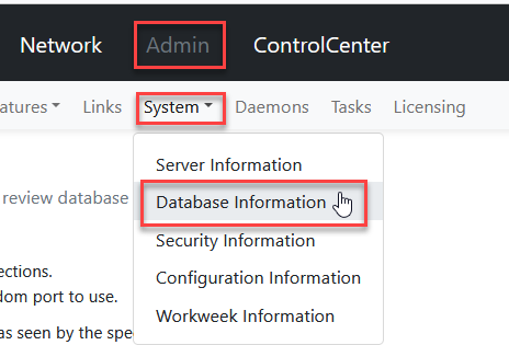

  1. Go to the Admin menu. Click on the System option, and select Database Information.
    Figure 1. Admin Menu
