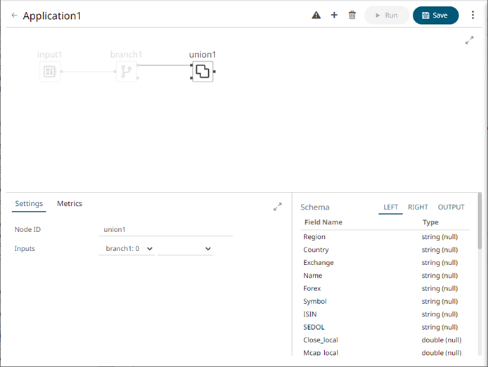

The Union node
icon displays in the Graph pane, as well as the properties to be defined in the Operator Settings pane, and the preview of the data in the Schema pane.
The left (inbound) edges allow you to select the input streams. The right (outbound) edge allows you to connect to the other operators.
- In the Operator Settings pane, define or select the following required properties:
Property Description Node ID
The ID the union operator.
Inputs

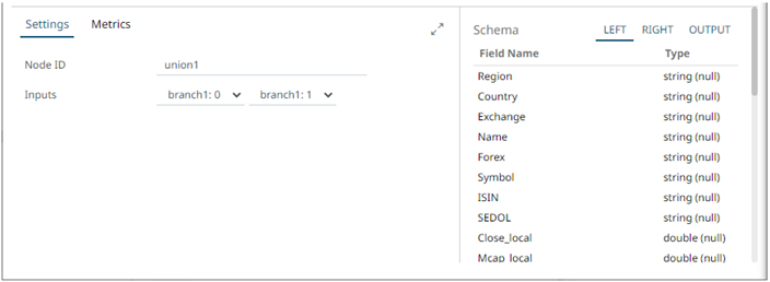

The left input stream automatically connects to the currently-selected operator. You can select another ID of the operator that will be the source of the data in the Inputs drop-down list.
Then select the right input stream.
The preview of the data (LEFT, RIGHT and OUTPUT) is displayed in the Schema pane.
