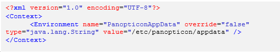

- Copy the file panopticon.xml from the .ZIP file and place it in the Tomcat config folder (/tomcat_home/conf/Catalina/localhost).
- Edit the Environment value property to the path where you want to keep Panopticon server content, for example:
NOTE:
- Instead of setting the path of the environment variable PanopticonAppData on the panopticon.xml file, you can do so on the System Environment Variables. For example:
Variable New Value PanopticonAppData /etc/panopticon/panopticondata - If the directory path is set in both an environment variable and in the panopticon.xml file, the value set in the XML file will take precedence.

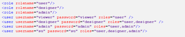

- For a basic installation using the Tomcat inbuilt XML file user directory, copy the provided tomcat-users_example.xml and overwrite the existing tomcat-users.xml file which is available in the Tomcat config folder (/tomcat_home/conf).
The provided tomcat-users_example.xml contains the following roles and users:
