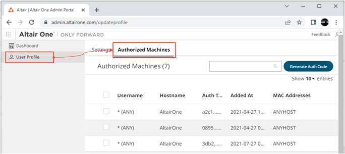

- Log on to Altair One (https://admin.altairone.com) then navigate to User Profile and select Authorized Machines.
- Click

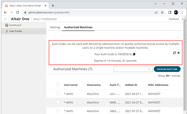

The page displays the auth code and a timer indicating the code’s expiration.
Click Copy to Clipboard
to copy the generated auth code. - Paste the generated code into the license.hwu.hosted.authorization.token property in the Streams.properties file.
