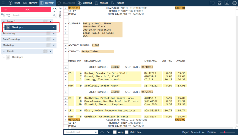

Working with Monarch Classic projects
If you open a Monarch Classic Project, the model is represented as a table on the Prepare window. Reports associated with model are represented as "sub-tables."
Selecting the report associated with a Monarch project displays the report in Report View.

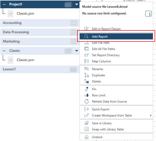

Add more reports by selecting the drop-down beside the main table and selecting Add Report.
Note that you must select a report that is compatible with the model you opened. Moreover, you cannot add the same report that is already being used in the model. In this case, the report will be skipped and will not be added to the model. The following warning popup will display:

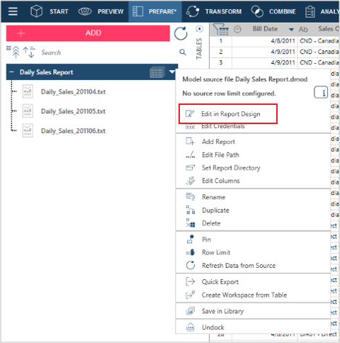

Modify the model associated with a Monarch Classic file by selecting Edit in Report Design.

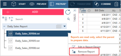

To delete a report, right-click on the report you want to delete and select Remove Report from the context menu:

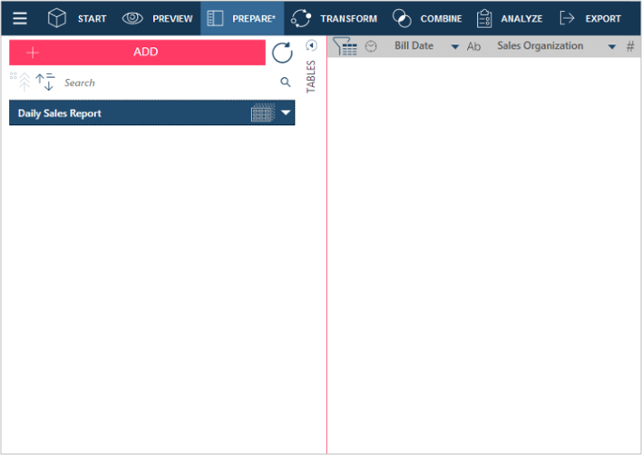

If you opened a Monarch Classic model, the model is represented as a Table on the Prepare window. At this point, no data are displayed:
To view data, you must add reports compatible with the model. To do so, select the drop-down beside the main table and select Add Report:

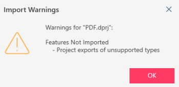

When a project/model containing elements not supported by Monarch Data Prep Studio is loaded into the application, a warning popup will display.
You cannot add the same report that is already being used in the model. In this case, the report will be skipped and will not be added to the model. The following warning popup will display:
