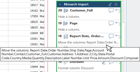

By default, the Change History panel is displayed when in the Prepare window. If your Change History panel is collapsed, select it to expand it.
The Change History panel displays:
Review your history of changes.
If the title or description of a change item is truncated because the panel is too small, hover your mouse over the title or description. A tooltip with the complete title or description displays.
