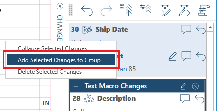

  1. Using CTRL + Click select all of the changes you want to include into a change group from the Change History list.
  2. Right-click on your mouse and, from the options that display, select Add Selected Changes to Group.

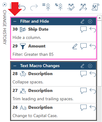

    The change group displays as below:
  4. Undo a change group (i.e., ungroup a set of changes) by right-clicking on the change group header and then clicking Ungroup Changes.
