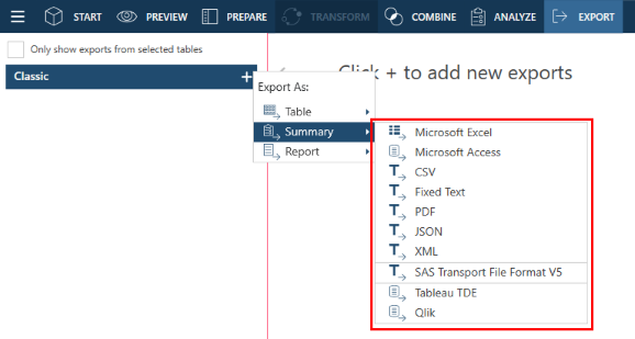

Click the Export tab to display the Export window.
Click on the
Add Export button located to the right of the table from which you created a summary, and from the options that display, select an export format.
You can export summary tables to the following formats:
Microsoft Excel
Microsoft Access
CSV
Fixed Text
PDF
JSON
XML
SAS Transport File Format V5
Tableau TDE
Qlik

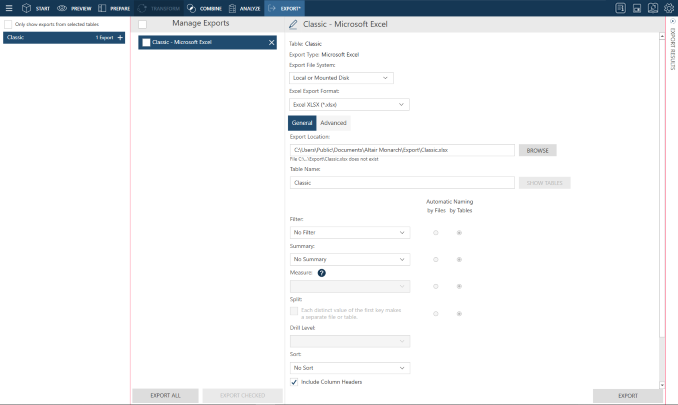

The table you selected displays in the Export Management panel and its properties display in the Export Properties panel.
Rename the export if you wish by clicking on the Edit
button located to the left of the Export name and then entering a new name into the field. -
Specify general export settings as necessary. Your export options will vary depending on the export type. The table below describes these settings.

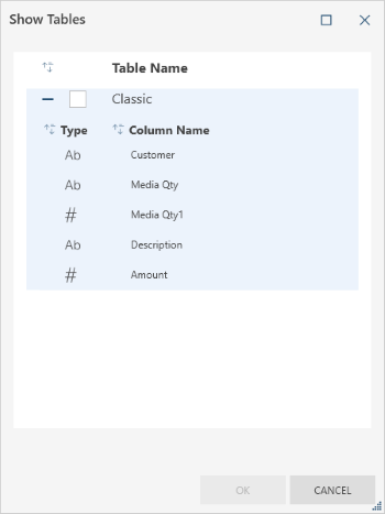

Show Tables |
When exporting a table to a file that already exists, this setting allows you to see the destination file’s existing tables and columns and select the table to which the data should be appended or overwritten. When a table from the Show Tables dialog is selected and confirmed, the name of the selected table is inserted into the Table Name textbox and the current content of this box is overwritten. The tables displayed in the Show Tables dialog may be sorted by name by clicking on the sort icon in the header. The tables have an expander button that allows you to view a list of columns belonging to that table.

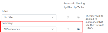

This setting specifies what filter to apply to the table when it is exported. When All Filters is selected as a filter option for Excel and Access file types, you will be asked to specify your desired Automatic Naming setting:
Summary |
All |
This setting specifies which summary to export. Use the drop-down provided to select a summary. When All Summaries is selected as a filter option for Excel and Access file types, you will be asked to specify your desired Automatic Naming setting:

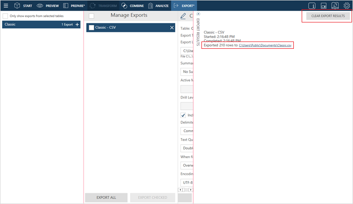

Click the Export button located at the bottom right of the window to execute the export operation.
When the export operation is completed, the Export Results panel displays.
- If the export was completed successfully, an export link will appear. Clicking on this link launches the folder to which you saved the exported summary.
- You can erase all export results from this panel by clicking on the Clear Export Results button located at the top right-hand corner of the panel.
