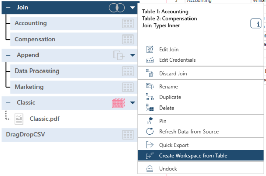

You can export tables, including all of the changes made to them and any parent tables, into a new workspace.

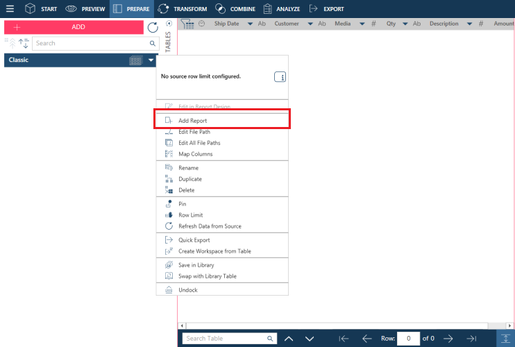

In the Prepare window, right-click on a table you wish to export to a workspace from the table selector and then choose Create Workspace from Table from the options that display.
Use the Save As dialog that appears to specify a workspace name and save location.
Click Save when you are finished.

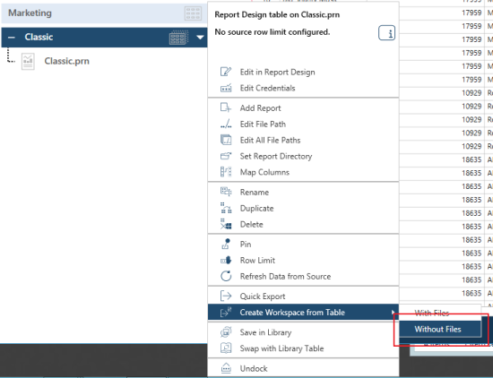

In Data Prep Studio, you can save a model node created in a pre-existing workspace into a new workspace with or without the report file included.
From the table selector, right-click on a report-based table you wish to export to a workspace and then, from the options that display, choose Create Workspace from Table > With Files to include the report file(s) or Create Workspace from Table > Without Files to exclude the report file(s) during export.
If you choose to export the model node to a workspace without the report file(s), you will need to supply a report file when you open the workspace to carry out any data prep operation.
