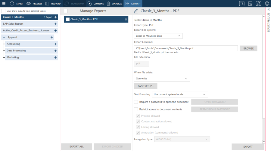

Click the Export tab to display the Export window.

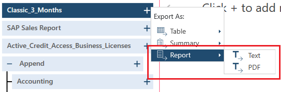

Click the Add Export
button located to the right of the table you wish to export as a report, and from the options that display, select an export format.
You can export tables to the following formats:
Text
PDF
The table you selected displays in the Export Management panel and its properties display in the Export Properties panel.
Rename the export if you wish by clicking on the Edit
button located to the left of the Export name and then entering a new name into the field. -
Specify general export settings as necessary. The table below describes these settings.
Field |

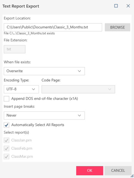

Encoding Type |
This setting specifies which encoding type to apply to the text file. At present, the encoding types Code Page, UTF-8, UTF-16LE, and UTF-16BE are accepted. |
Code Page |
When the encoding type selected is Code Page, this setting specifies which code page to apply to the CSV file. |
Append DOS end-of-file character (x1A) |
This setting instructs the application to add a DOS EOF character to the export file. |
Insert page breaks |
This field describes where page breaks will be added in the export file. It also has the option to not add page breaks at all. The following options are available:
Automatically Select All Reports |
All |
This setting instructs the application to automatically include all reports associated with the table in the export file. |
Select report(s) |
All |
This setting shows all reports contained in the table being exported. Select the checkboxes of the reports you want to add to the export file. |

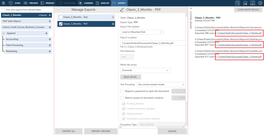

Click the Export button located at the bottom right of the window to execute the export operation.
When the export operation is completed, the Export Results panel displays.
- If the export was completed successfully, an export link will appear. Clicking on this link launches the folder to which you saved the exported summary.
- You can erase all export results from this panel by clicking on the Clear Export Results button located at the top right-hand corner of the panel.

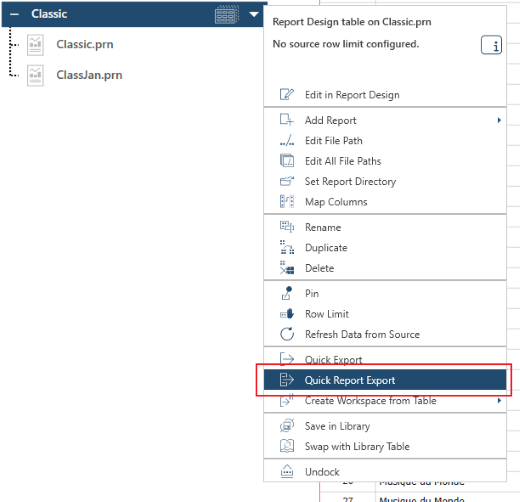

In the Prepare window, click on the dropdown arrow located to the right of a table you wish to export to display its context menu and then select Quick Report Export from the options that display.
Alternatively, you can select this table in the Export window, right-click on your mouse and then select Quick Report Export.

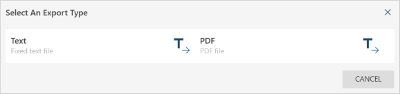

The Select an Export Type dialog displays.
Choose a file type to which your report should be exported.
