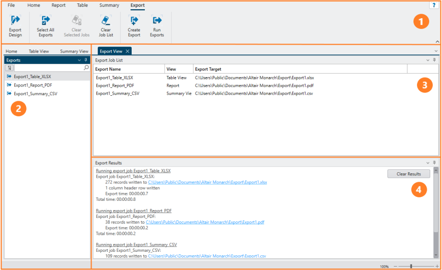

Export View allows you to create and run export definitions.
The Export View interface has the following elements:
Panel |
Description |
1 |
Ribbon Display all the tools you need to work with an export. Refer to the Export View Ribbon Quick Reference. |
2 |
Export Selector Allows you to search for and/or select a specific export. |
3 |
Export Job List Displays a list of all exports intended for running. |
4 |
Export Results Displays the results of all Run Export operations. |
