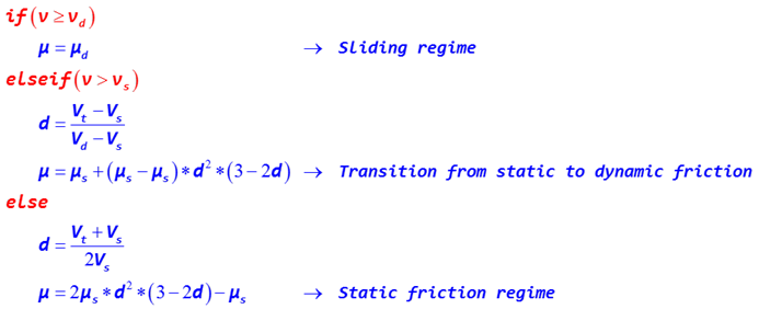

mu_static
Defines the coefficient of static friction when the friction is in the static regime.
MotionSolve uses a step function to transition between the static and dynamic friction regimes.
mu_static > 0
See Comment 7 for more details.
mu_dynamic
Defines the coefficient of dynamic friction when the friction is in the dynamic regime.
MotionSolve uses a step function to transition between the static and dynamic friction regimes. The coefficient of dynamic friction must be smaller than or equal to the coefficient of static friction.
mu_staticmu_dynamic > 0
stiction_trans_vel
The velocity at which the friction regime transitions to stiction.
friction_trans_vel
The velocity at which the friction regime transitions to friction.
|friction_trans_vel| ≥ |stiction_trans_vel|

  7. Two friction models are supported in MotionSolve
    • Coulomb model of friction which calculates the friction force as the normal force multiplied by the coefficient of friction. This coefficient is calculated as a function of the slip velocity that is explained below
    • A user defined friction force model that can be implemented as a subroutine or a script
      For the first approach, the friction force at the contact patch is computed in the same manner for POISSON, IMPACT and VOLUME force models. The Coulomb friction law is used which models the friction force as a coefficient of friction multiplied by the normal force. The coefficient of friction is modeled as a function of the slip velocity. The frictional force is modeled as a viscous force according to the following equations:
    where,
    Vt
    is the current slip speed at the point of contact
    Vs
    is the stiction transition slip speed at which the full value of μs is used for the coefficient of friction
    Vd
    is the dynamic friction slip speed at which the full value of μd is used for the coefficient of friction
    μs
    is the coefficient of static friction
    μd
    is the coefficient of dynamic friction
