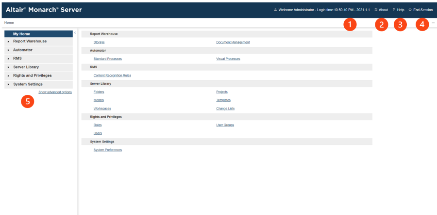

Main Page of MSAdmin
Upon logging in successfully, the main page of MSAdmin is displayed.
Panels and Functions |
Description |
1 |
Login Details This shows the last login time and the current version of the application. |
2 |
About Clicking this button opens the About window that shows details such as product version, assembly version, SDK version, and DataPrep version. Company information and a link to the list of open-source software used are also shown here.
NOTE: For Monarch Server 2024, the SDK and DataPrep versions are as follows: SDK version: 24.1.0.37261 DataPrep version: 24.1.0.37261 |
3 |
Help Clicking this button opens a related page in the Administrator's Guide. |
4 |
End Session Clicking this button logs you out of the application. |
5 |
This panel serves as the navigation point for Monarch Server. Click Show advanced options to see all available sections in the system. |
