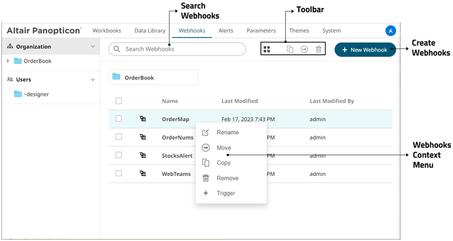

Search Webhooks
Entering text will filter the webhooks.
Toolbar
Allows copying, moving, and removing of webhooks.
Also, to display the webhooks list either on List View or Grid View.
Create Webhooks
Allows creating new webhooks.
Webhooks Context Menu
Allows renaming, moving, copying, deleting, and enabling of the trigger of webhooks.
