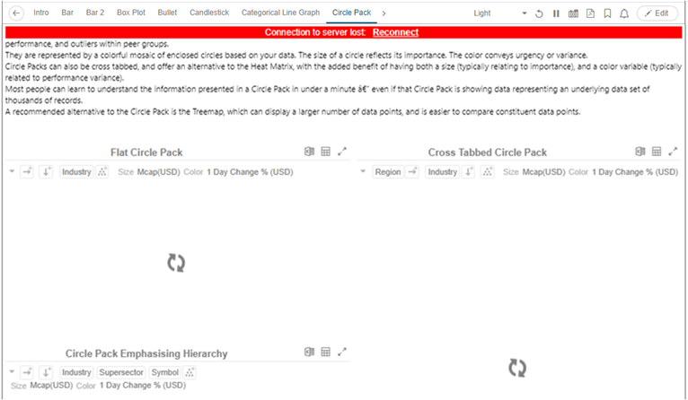

When the client loses connection to the server, by default, it will no longer attempt to automatically reconnect to the server.
A notification message displays such as below. Clicking the Reconnect link will attempt to reconnect to the server.

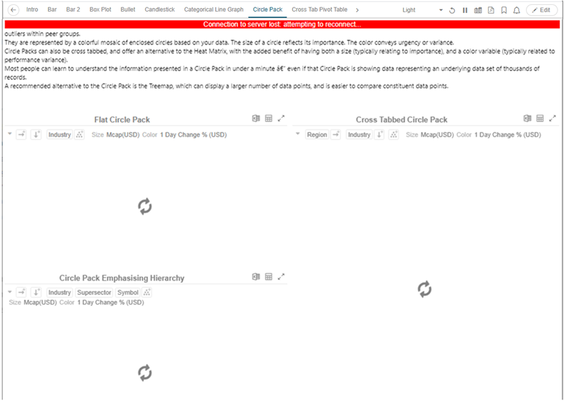

A notification message displays such as below. Connection to server lost: attempting to reconnect…
