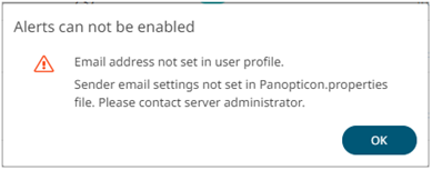

Otherwise,
when trying to enable an alert, this error will be displayed:
Save the updated
file and restart Tomcat.
