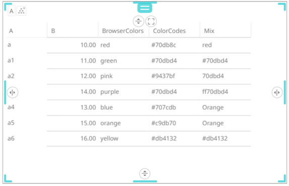

For example, the data table has the following columns:
A |
B |
BrowserColors |
ColorCodes |
Mix |
a |
10.00 |
red |
#70db8c |
red |
a1 |
11.00 |
green |
#70dbd4 |
#70dbd4 |
a2 |
12.00 |
pink |
#9437bf |
70dbd4 |
a3 |
14.00 |
purple |
#70dbd4 |
ff70dbd4 |
a4 |
13.00 |
blue |
#707cdb |
Orange |
a5 |
15.00 |
orange |
#c9db70 |
Orange |
a6 |
16.00 |
yellow |
#db4132 |
#db4132 |
The values of the BrowserColors, ColorCode, and Mix columns can be used as colors (background or text) for a column in the visualization.

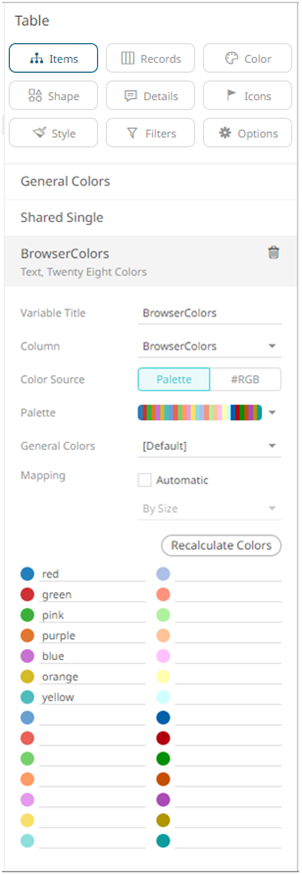

1. To associate other columns from the data table, drag and drop them to the Color variable drop area. Select one to display the corresponding configuration pane.
Note

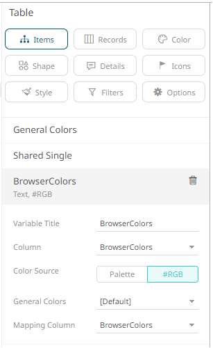

that the values of the BrowserColumns column do not match the
associated color palette. To use the color names, select the #RGB
Color
Source.
2. Select the General Colors that will be used for the Color variable.
3. Select the Mapping Column that will be used when new data is dynamically loaded into the visualization.

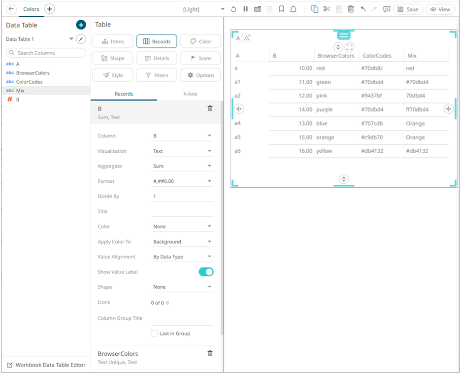

For this sample table visualization:

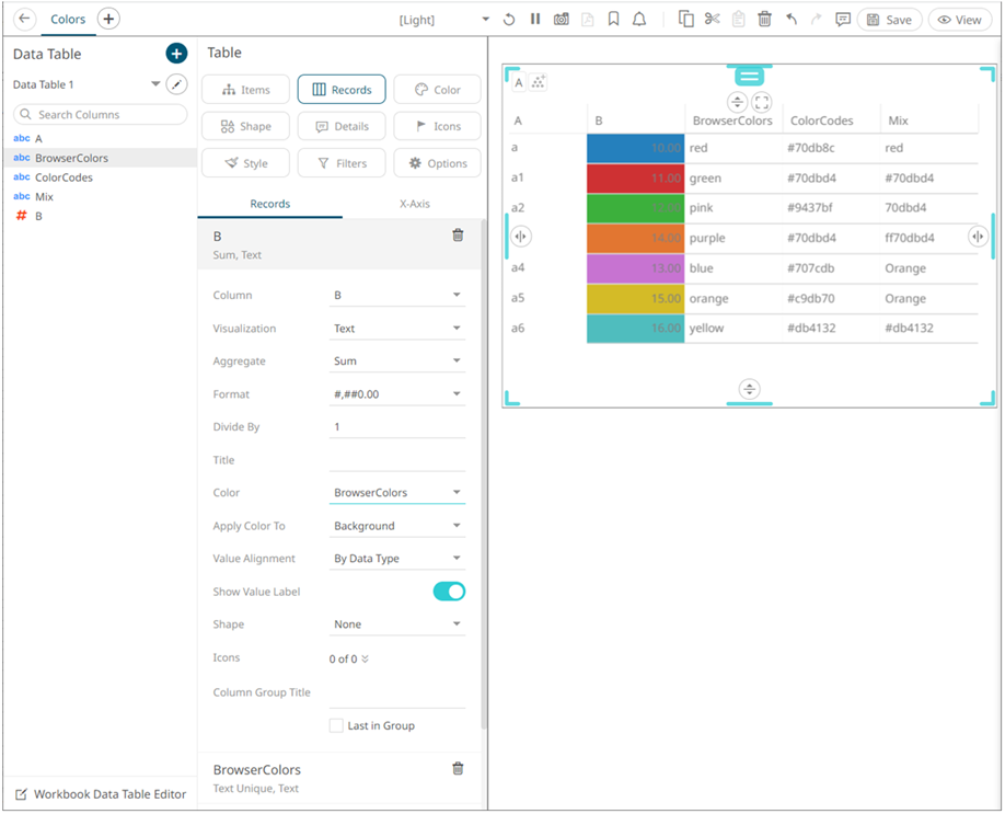

If you want to use the colors in the BrowserColors column as background for the B column, you can do so by selecting B under the Records pane list.
In the Color drop-down list, select BrowserColors.
The values of BrowserColors column are applied as the background color of the B column.
