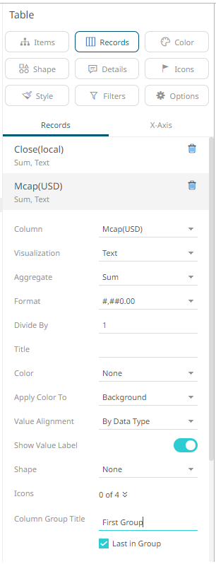

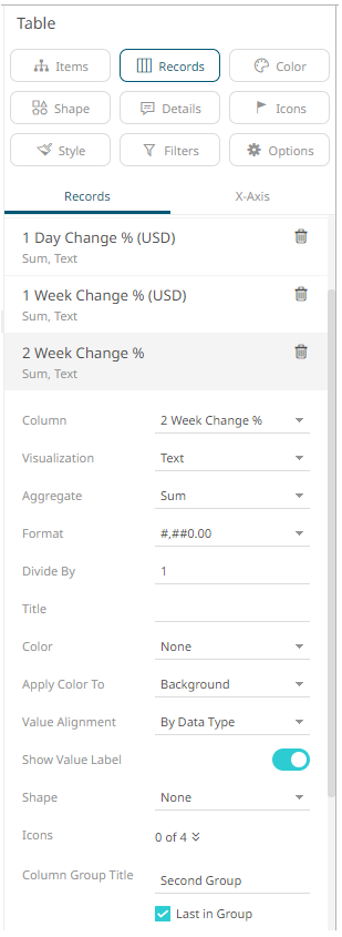

3.     For the groupings, click the following columns, check the Last in Group box, enter the Column Group Title, and click :
·         First group: Mcap(USD)
·         Second group: 2 Week Change %
