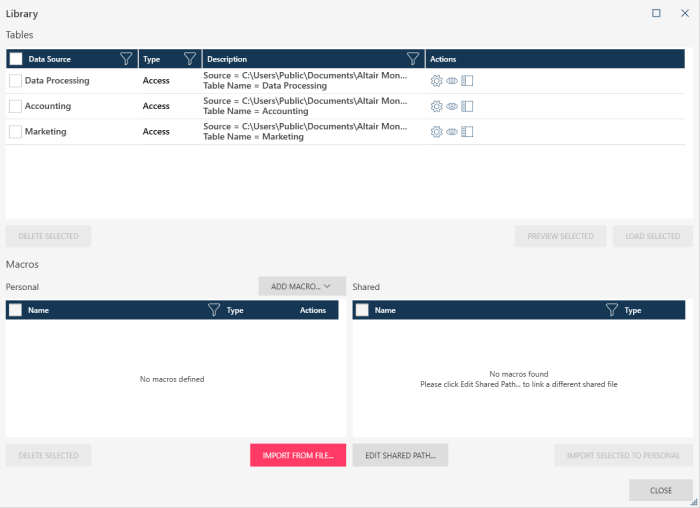

These data sources are listed in the Library dialog.

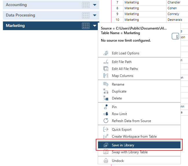

On the Prepare Window, click the drop-down arrow beside a table.
A box displays showing table information as well as table actions:
Note that actions vary according to the type of table selected.

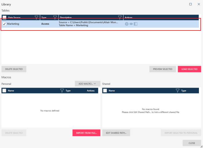

The Data Source Library dialog displays and shows an entry for that data source in the Local tab.

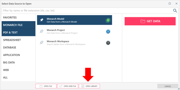

Select Open Library from the Select Data Source to Open dialog box:
The Library displays.
On the Actions column, select an action
beside a Data Source to do the following:-
Edit a data source load options. You can select to:
Edit the load options. Note that load options vary depending on the source type. For instance, if the data source is an Excel file, you can set if the first row has column names, select to skip n number of lines, or select a different table/sheet.
Edit the file path where the source is located.
Duplicate the data source
Delete the data source
Load the data source into the workspace.
Preview the data source, in the Preview Window.
Select a data source and then click the Load Selected button on the dialog to open it.
