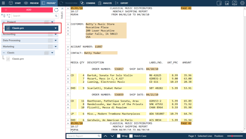

If you open a Monarch Classic Project, the model is represented as a table on the Prepare window. Reports associated with model are represented as "sub-tables."
Selecting the report associated with a Monarch project displays the report in Report View.

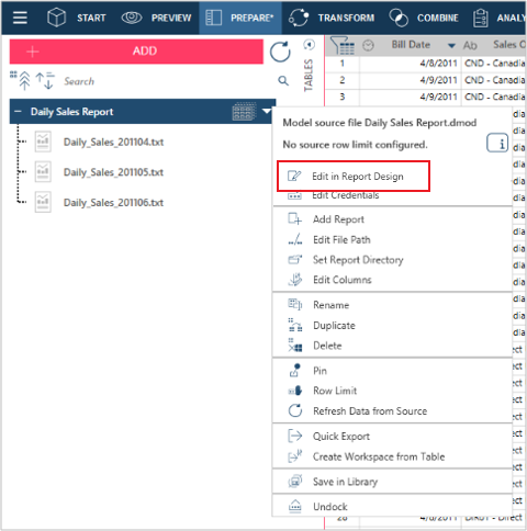

Right-clicking anywhere in Report View displays a context menu that allows you to:
Edit the report in Report Design

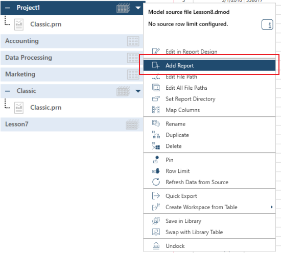

Add more reports by selecting the drop-down beside the main table and selecting Add Report.
You must select a report that is compatible with the model you opened.

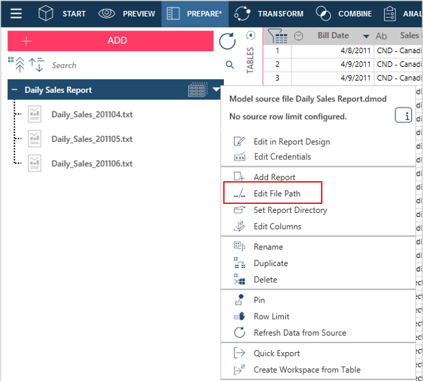

Edit a report's file path by selecting the drop-down beside the main table and selecting Edit File Path.
Modify the model associated with a Monarch Classic file by selecting Edit in Report Design.

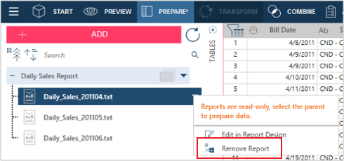

To delete a report, right-click on the report you want to delete and select Remove Report from the context menu:

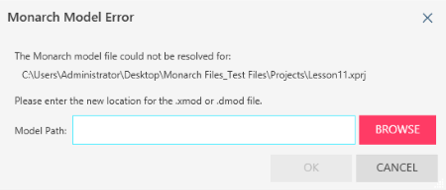

If you open a Project that uses a model that cannot be located, Monarch Data Prep Studio will display a dialog box telling you that the model cannot be found. Click the Browse button to look for the model and point the model to the correct location.
A similar dialog is produced if the report associated with a model cannot be found.

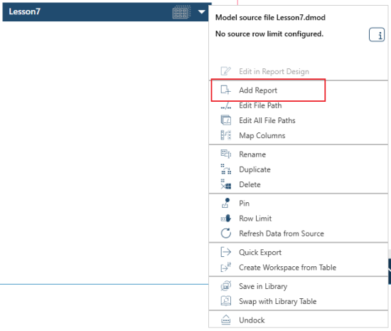

If you opened a Monarch Classic model, the model is represented as a Table on the Prepare window. At this point, no data are displayed:
To view data, you must add reports compatible with the model. To do so, select the drop-down beside the main table and select Add Report:
Note:
You can Prep, Transform, and Combine data only if you select the main table. You can only view the data if you select a report (you cannot Prep, Transform, and Combine data).

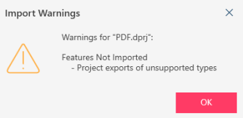

When a project/model containing elements not supported by Monarch Data Prep Studio is loaded into the application, a warning popup will display.
