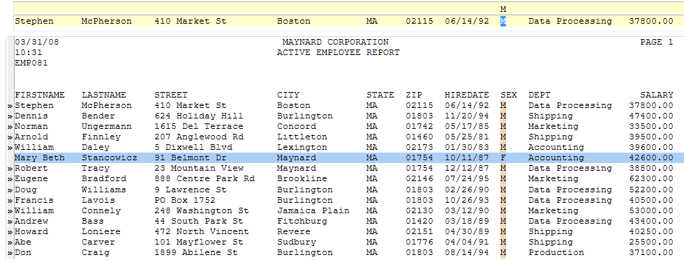

    In the graphic below, note that the "M" in the trap line has been highlighted. Currently the "M" is trapping the data for only the male employees (note that for the sixth employee down, "Mary Beth Stancowicz", the data has not been trapped).
    Highlighting the "M" trap character and activating the NOT trap button.
