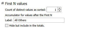

First n Values |
Select this option to build the summary using only the first N key field values.
This option is applied after the summary is sorted. By selecting the Measure sort option (see the Measure option on the Sorting tab below), you can use this feature to display a top n analysis or bottom n analysis of your data. For example, you can use this feature to create a summary that breaks out total Sales amounts for each Salesperson in your company, then limits the summary to only the top ten salespeople. By selecting Salesperson as a key field and Sale_Amounts as a measure, you could then sort the Salesperson key by the Sale_Amounts measure (in descending order). This would result in a summary that displays salespeople ranked by total sales, with the top selling salesperson first and the bottom selling salesperson last. You could then select the First n Values option for the Salesperson key, setting n to 10. The resulting summary would display the top ten salespeople in terms of total sales, with all other salespeople grouped together under a single label (the "All Others" label). |

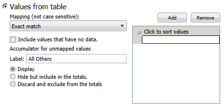

Values from table |
Select this option to build the summary using only those key field values you specify:
Another use for this option is to create a specific sort order for the key values. Monarch Classic allows you to sort by key fields or measures, but the order is ascending or descending, either alphabetic or numeric, depending on the field type. There are some cases where you want to define the sort order exactly, e.g., with months of the year. Use the Add current values button to select key field values from a list or type your own list of values that you want to use when building the summary. Monarch Classic will follow the order in the which the values are displayed on the list. Use the Mapping drop-down select how values are mapped:
Click include values that have no data to include the value in the summary, even if there are no matching records found in the report. Accumulator for unmapped values label will be used to identify all values that are not included in the list. You can also select to display, hide, or discard all unmapped values. |

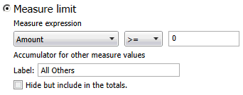

Measure limit: |
Select this option to build the summary using only those key fields where a selected measure’s subtotal value meets either an upper limit or a lower limit. The lower limit is expressed as "at least n" and the upper limit is expressed as "at most n".
For example, when creating a summary to show product quantities broken out by Customer, you might want to view only those customers whose purchase amounts are greater than $5000.00. By selecting Customer as a key field and Amount as a measure, you could then select the Measure limit option, select Amount from its drop-down list, select the ">=" operator, and enter $5000 in the associated edit box. The resulting summary would display all customers that purchased more than $5000.00, with all other customers grouped together under a single label (e.g., the "All Others" label). |

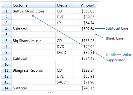

After each key value change insert subtotal line |
Select to insert a subtotal line. A subtotal line accumulates all the measures for the current key. |
Insert n blank line(s) after each key value change |
Select this option to insert a blank line at the end of a key field group (see illustration below). When the "Insert subtotal line..." option is also selected, Monarch Classic inserts the subtotal line first, then the blank line. |
Text |
Enter text to describe the subtotal. By default the word "Subtotal" is used. You can also select additional options to display the key value together with the text:

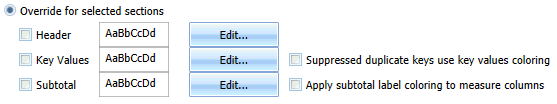

Override for selected sections |
Select this option to override the defaults and define colors for the header, key values, and/or subtotal. If you click on this option, color samples will display for each section. Click the Edit button beside the preview box next to a section to display the Color Properties Dialog then use the dialog to set the text color, fill color, pattern style and pattern color.
Check Suppressed duplicate keys use key values coloring if you want suppressed duplicate keys to use the same colors as the key values. Check Apply subtotal label coloring to measure columns to make measure columns use the same colors as the subtotal label. |
