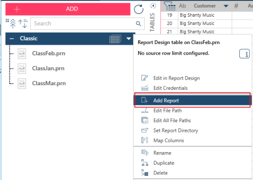

You can load multiple reports into this node by clicking on the drop-down button located to the right of the parent table and then selecting Report Options > Add Report.
Note, however, that added reports must have the same format and be of the same file type to enable correct data capture.
