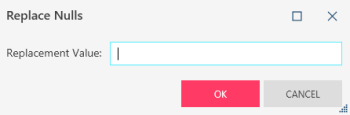

When you apply this operation, Prep Data first asks you to enter the characters you wish to replace nulls with:
If nulls in a text/numeric column are to be replaced, a textbox displays.
If nulls in a date/time column are to be replaced, a date/time picker displays.

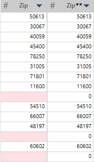

Example
In this example, the original column is Zip. The Replace Null Values operation was used to remove the null values and replace with 0 to produce the resulting values in Zip**.
