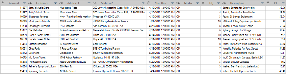

For instance you start with a table like this, where record pairs 1 and 2, and 7 and 8 are duplicates :
Show Duplicates will create a table like this:

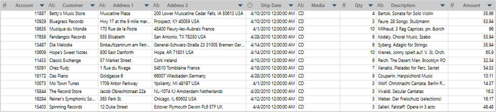

Remove Duplicates will create a table like this:

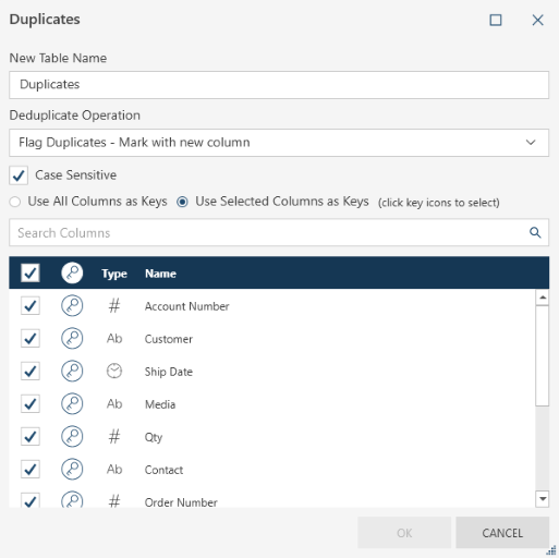

The Duplicates dialog box displays:
Enter the name of the resulting table.
Select the Deduplicate Operation from the drop-down.

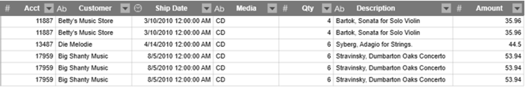

To understand the different operations, let us use the following as an example:
We have 2 sets of duplicates: Betty's Music Store has 2 duplicate records and Big Shanty Music has 3 duplicate records.

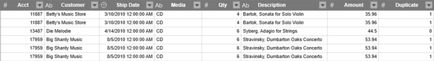

Flag Duplicates - Mark with new column
With this operation, Monarch Data Prep Studio marks all records that have duplicates.
With the records above, the result will be:

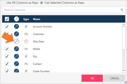

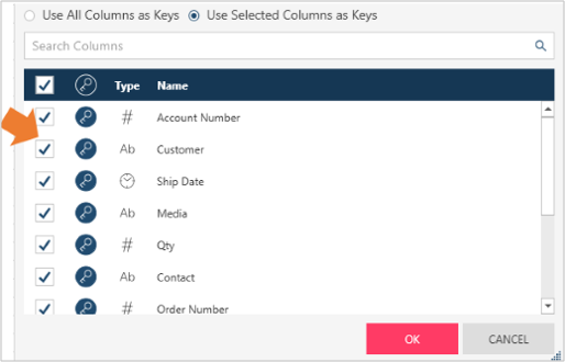

Unselect/select the columns you want to use in evaluating duplicates.
If a column is not selected, this column is ignored even if it has duplicated values.
Click the Case Sensitive box if you want to differentiate values based on case.
For instance, if case sensitive is on, "Betty's Music Store" and "betty's Music Store" are considered distinct values and will not be considered as duplicate.
Select the columns to be included in the resulting table.
Select Use All Columns if you want to display all columns.
Select Use Selected Columns, and then check the box beside the columns you want to include. Note that the Select All check box in this case is disabled if you are selecting columns via a column search (essentially filtering columns).
Select OK.
