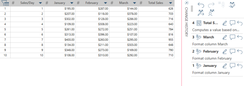

In the following example, Table A includes a record of daily sales for the first quarter of the year. In this table, the column names Sales/Day, January, February, March and April are used. The column Total Sales is generated by summing daily sales for these months.

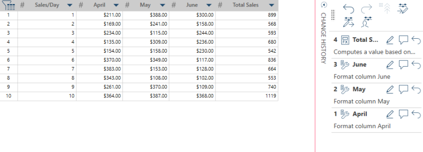

Table B below contains the exact same details in Table A, but its months include April, May and June. Because changes are made primarily based on column names, changes made to Table A will not be applicable to Table B, even if everything else about the tables is identical.

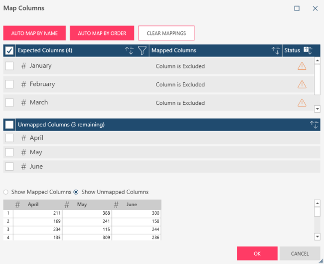

    The Map Columns dialog displays.
    The upper section of the dialog describes the columns expected in the input schema (Table A), while the lower section describes the columns available in Table B. You can also opt to view successfully mapped columns or unmapped columns in a preview located below these sections.

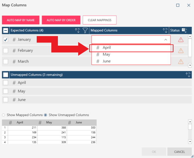

  3. In the upper section of the dialog, select a column in Table A to map to another column in Table B. Doing so activates the adjacent field below Mapped Columns. Click on the drop-down button that displays to select a column in Table B for mapping.

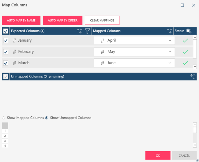

  4. Do the same for the rest of the columns requiring mapping. Table B is successfully mapped to Table A if green check marks display for all header names in the Status column.

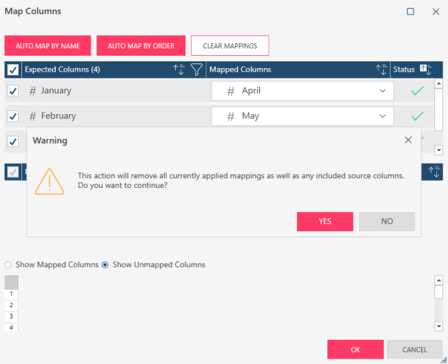

  5. If you wish to clear all mappings defined and start over, click the Clear Mappings button and then click Yes in the pop up that displays.
