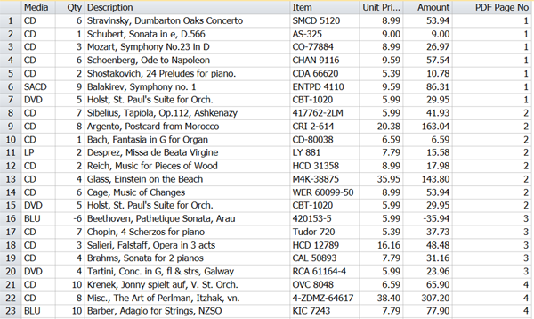

Calculated field example
Define a calculated field PDF Page No using the following expression: PDFPage()
On the table, the result is a PDF Page No column (last column on the right in the example below) displaying a page number for each row on the table:
