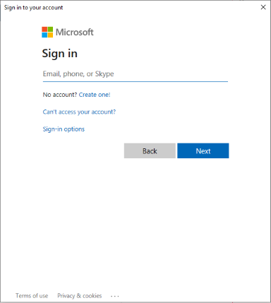

  5. The export operation is executed and the Power BI Export login dialog displays.
  6. Enter the information required to log into your Microsoft account.
    NOTE:
    Power BI does not support email addresses provided by consumer email services or telecommunication providers. This means email addresses appended with outlook.com, hotmail.com, gmail.com and others cannot be used for Power BI accounts.

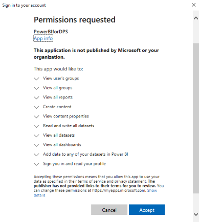

    The Authorize PowerBIExport dialog displays for first-time users.
  7. Click Accept.
    The export operation is performed and completed.

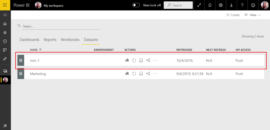

    If you log into your Microsoft Power BI account and access your workspace, the exported table should display in the Datasets list.
