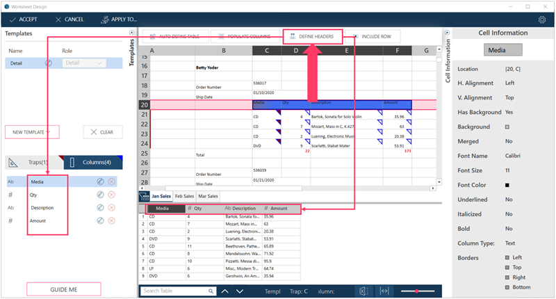

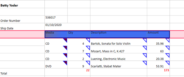

  1. After defining a column or set of columns, select the header(s):
  2. Right click and select Define Headers from the context menu, or select the Define Headers tool. .
    Headers are applied to the columns. These are reflected on both the columns list and Preview Grid:

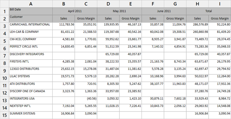

Some worksheets have headers that span several rows. For example rows 1 and 2 comprise the header for the worksheet.
A demonstration of how to capture multi-line headers is shown here.
  1. Select the rows that comprise your header:

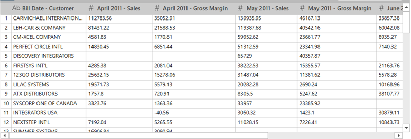

  2. Select Define Header from the context menu or select the Define Header tool.
    Worksheet Design combines the header text from the rows selected:
