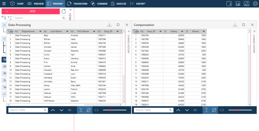

In this example:
The Data Processing and Compensation tables have been undocked and you can view both tables simultaneously and compare records.

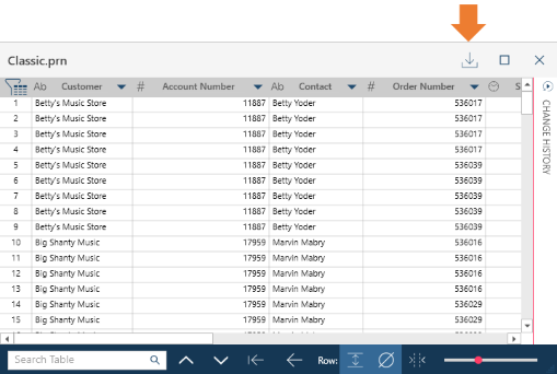

Select the Dock Table icon at the top right corner of an undocked table:
The table is returned to the main interface.
