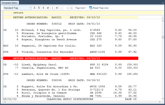

In the figure above, the line marked red is an exclusion trap. Because this trap specifies that a line with the word "return" at position number 7 should be excluded from extraction, an append template with a colon as its trap at position number 27 will extract the Order Number but NOT the Return Authorization Number, even when the colon of this excluded line lies in exactly the same position.
