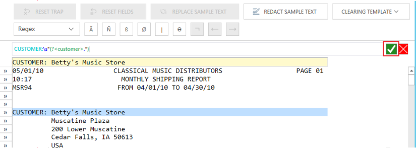

Consider the following regex traps that may be used to trap the Customer field of Classic.prn:
CUSTOMER:\s*(?<customer>[A-Z].*)
CUSTOMER:\s*(?<customer>.*)
While both traps will capture the text following the Customer field in the report, the first trap will  pick up text beginning with the letters A to Z only while the second trap will pick up text beginning with any alphanumeric character. Thus, the first trap will not capture 1999 Hot Spot as a Customer name but the second trap will. Both traps will (and do) capture Betty's Music Store as a Customer name.
Once the trap has been created, tick the Accept icon to apply this trap to the report.

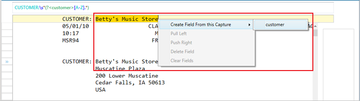

The fields identified by your trap are automatically highlighted. To add a field to your table, highlight this field in the sample line, right-click on your mouse, and then select Create Field from this Capture > <Field Name>.
