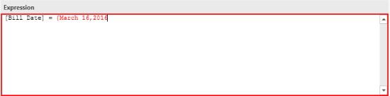

Monarch Data Prep Studio will highlight the Expression Builder with a red border if it finds errors in your expression:
In most cases, this means that your expression violates one of the rules described below.
