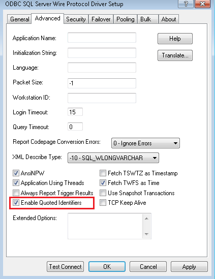

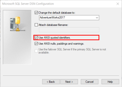

General Requirement: Enable Quoted Identifiers
Where applicable, you must enable quoted identifiers (e.g. the options Enable Quoted Identifiers or ANSI Quoted Identifiers) when you configure the ODBC Driver to use with the connector.
For instance:
Microsoft SQL Server DSN Configuration
ODBC SQL Server Wire Protocol Setup
