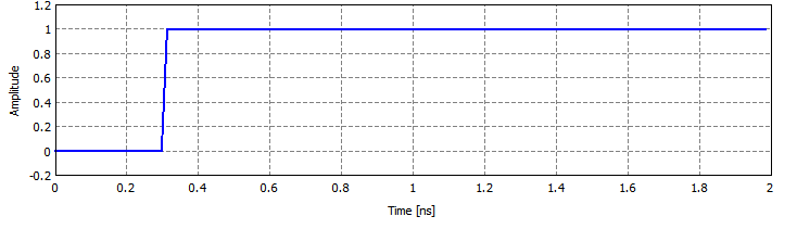

Define Step(t) = 1 for t > 0.3 ns
On the Create time signal dialog, in the f(t) field, add the following to define a step function with a delay of 0.3 ns:
(1) f ( t ) = s t e p ( t − 300 e − 12 )
Figure 1. The Signal preview shows the step function with a delay of 0.3 ns.

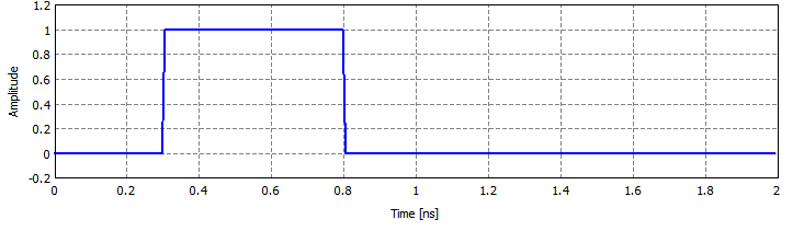

Define a Rectangular Pulse
In the f(t) field, define a rectangular pulse with a duration of 0.5 ns by extending Equation 1 to:
(2) f ( t ) = s t e p ( t − 300 e − 12 ) − s t e p ( t − 800 e − 12 )
Figure 2. The Signal preview shows the rectangular pulse with a delay of 0.3 ns with a duration of 0.5 ns.

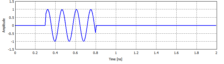

Define a Sine Wave Pulse
  • In the f(t) field, define a sine wave pulse with a delay of 0.3 ns and a duration of 0.5 ns by extending Equation 2 to:
    (3) f ( t ) = ( s t e p ( t − 300 e − 12 ) − s t e p ( t − 800 e − 12 ) ) * sin ( 2 * 3.14 * ( t ) * 7 e 9 )
    Note: Predefined variables are not supported. Use a value of 3.14 instead of pi.
    Figure 3. The Signal preview shows the sine wave pulse with a delay of 0.3 ns and a duration of 0.5 ns.
    Note: Equation 3 and Figure 3 correspond to a modulated step signal at 7e9 GHz.

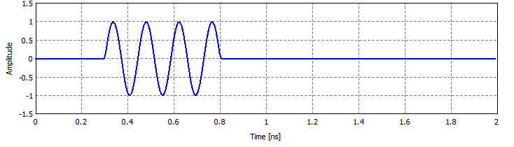

  • Add a delay of 0.3 ns to the sine wave by extending Equation 3 to:
    (4) f ( t ) = ( s t e p ( t − 300 e − 12 ) − s t e p ( t − 800 e − 12 ) ) ∗ sin ( 2 * 3.14 * ( t - 300 e - 12 ) * 7 e 9 )
    Figure 4. The Signal preview shows the final sine wave pulse.
