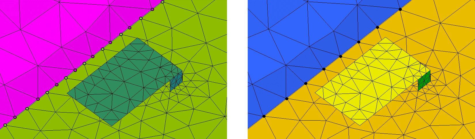

Figure 1. Left: Mesh parts that have no mesh connectivity (triangles do not share
vertices on a common interface); Right: Mesh parts that have mesh
connectivity.

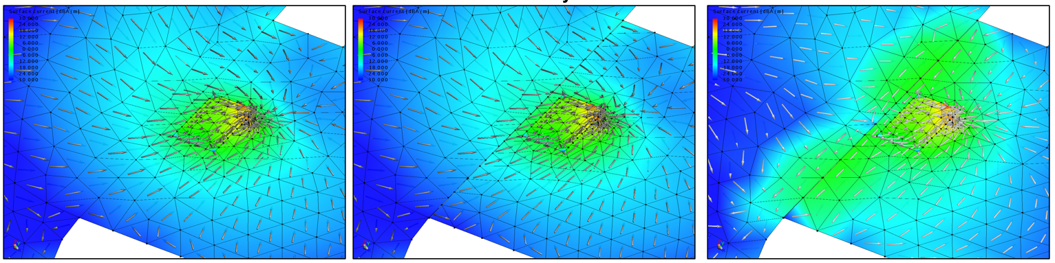

Figure 2. Left: Mesh parts that have mesh connectivity; Center: Mesh parts that do not
have mesh connectivity but have domain connectivity defined; Right: Mesh parts
that have no mesh connectivity.
