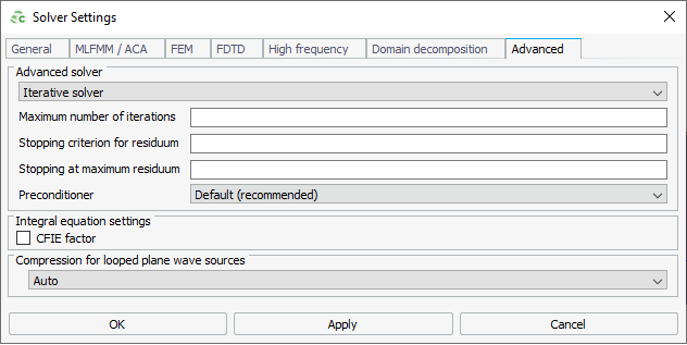

On the Solve/Run tab, in the
Solution Settings group, click the
Solver Settings icon. On the Solver Settings dialog, click the
Advanced tab.
Figure 1. The Solver Settings dialog (Advanced tab).
